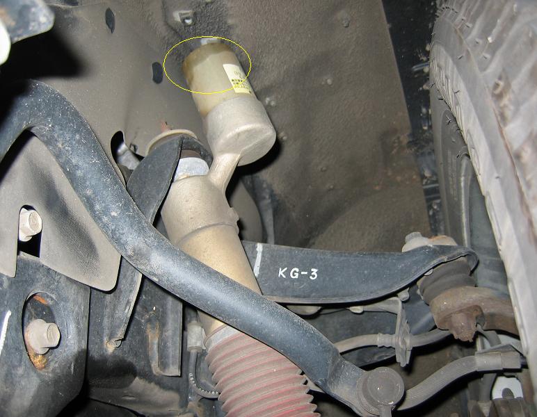

    here's a picture....
    Ok, here is a picture of my front left shock. There is some kind of stain or fluid at the top where I circled. It doesn't seem like water and it hasn't rained here, it's just at the top too...doesn't go below that and there is no drips down further or puddling to the ground.
    Would this be a leak??

    That sir, is a leak.
    Not in a typical location either. Most (I assume) of our leaks have been from the bottom of the shock (inside the boot, where the shaft enters the shock body).
