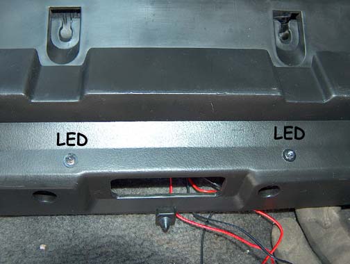

    Remove the top part of the glove box....very easy to do. The drawer of the box if pressed in on both sides will fold down and out of your way, so you dont even have to remove the glove box drawer. Once you remove the glove box top molding, find the best place to drill your hole(s). The leds I bought had a little black clip around the bulb that worked great for holding the led in place, assuming the correct size hole is drilled. Anyway at this point it should look something like this.
    NOTE Be sure not to mount the leds to far back or they wont shine directly into the glove box due to the position of the glove box tray, you will end up lighting up the back of your glove box lol. The position mine are in, seems to be just about right.

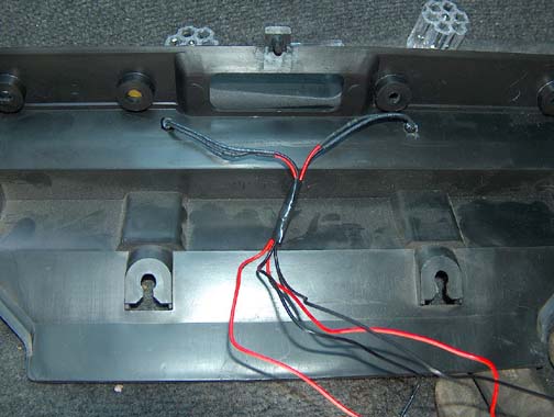

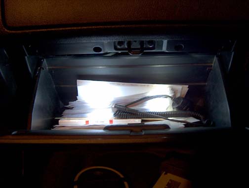

    Wiring was easy, I wired them to the lighter because when the key is off the lighter doesn't work, I dont have to worry about a dead battery, although that would probably take a long time with 2 leds. I chose to use a mercury switch, mostly because I already had one onhand and they can be literally zip tied, taped, etc, in any location or place. The switch was mounted on the side of the glove box drawer, suprisingly there are not many locations that will allow for enough motion to clearly operate the switch in both directions. The end result is the pic below.
