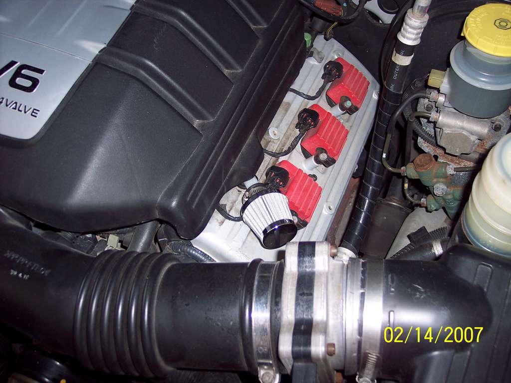

    That will happen when the pcv valve sticks. It will suck the oil from the valve cover. That is why my PCV valve is gone. No more worries. I did notice that the other line from the valve cover also had some oil in it. But I haven't had time to take care of it. I plan on either installing another breather or connecting to the one I already have on the other side. Shawn
