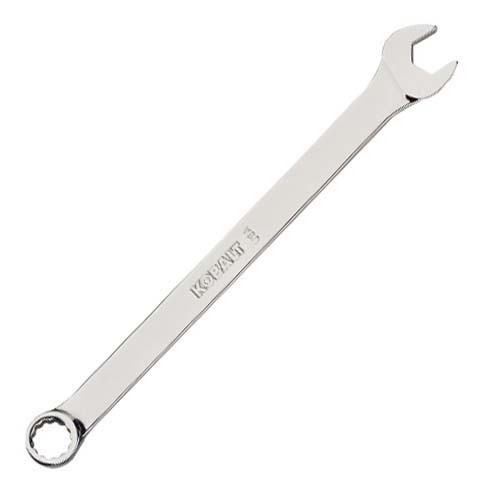

    Put that adjustable wrench away before it does any harm! They suck for most applications, in my book. I prefer to use a box-end hand wrench for sticky nuts and bolts...
    I think that's the most secure and reliable wrench for high-torque applications. I've split sockets on stuck bolts before, and broken adjustable wrenches, too. Even a cheapo box wrench will not open up or turn out the corners on a bolt.

    Oh, if you have a six-point box end wrench or socket use that as it'll grip the bolt face the best and resist rounding of the corners.

    I doubt he has a 22mm box end. Just go buy a socket and a ratchet + breaker bar = win. Get a long bar while you're at it and apply pressure slowly. Hopefully you won't shear the bolt.
    right you are.. ive got a pretty good tool collection.. but alas.. only up to 19mm box end wrenches... i went out to buy a 22mm wrench.. advanced auto and autozone only had up to 19mm too... so i suppose ill be going to sears tomorrow
