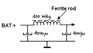

    What you need is a good capacitor!
    VX : CLOSEST THING TO A CONCEPT CAR!
    Quote Originally Posted by thedutchguy
    (in my best Christopher Lloyd voice)
    A FLUX CAPACITOR !!!
    No, seriously, well actually it consists of 2 caps with a homemade coil.
    like in the pic added.
    The coil is made from .8 mm. wiring. You can wind the coil around 40 cm of PVC tube used in home electrics.
    Good luck this will filter everything guaranteed!
